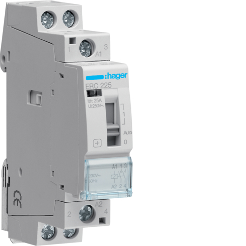

    Obviously, there exists an issue with inductive load at Shelly pro 4PM. Please have a look at this thread: Click! (Mostly in German language - you may use a translation app…)
    It seems some users have solved the issue with snubbers across the relay coil.
  • thank you thgoebel
    if i understand the solution is connect one snubber beteween A1/A2 ?
    Externer Inhalt i.ibb.co
  • Perfect!
