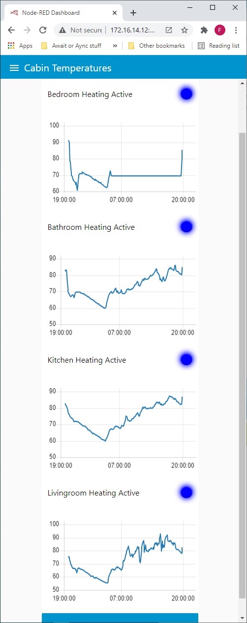

  • The bedroom H&T is:  20210312-133748/v1.10.0-rc5-g1c546b5
    Externer Inhalt www.crystalpoint.com
    As you can see from the above graphic the bedroom sensor got stuck about 6:30AM, note it continued to report every ten minutes and I power cycled it around 7:40PM, at which time it will track the temperature until it get's stuck again. Note when it got stuck the report turned the heat on and I woke up sweating because it was too hot.
    Ten minutes is too course of reporting period when you are using it for climate control in a small space. That's why I requested the ability to specify the time period...
