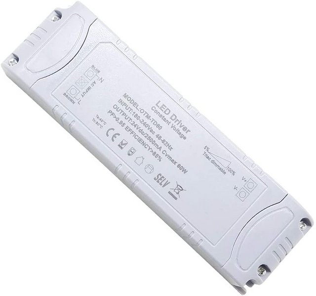

  • Hi, this is my first Shelly dimmer 2 so I may be ask something obvious so please excuse me in advance.
    I mounted the Shelly dimmer 2 on a 5w x 6 LED chandelier operating with the power supply below:
    The problem is tha the power supply (not Shelly nor leds) buzzes very loud when I turn the light on. After some tweaking I found out that calibrating the shelly with trailing edge stops the buzzing at 100% lighting. But It doesn't make sense using a dimmer if you can use it just at 100%....

  • hi SebMai , thanks.
    Do you think this led driver should work?
    I read "24v" as output but it should be read as "until 24v" ?
